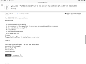

Just a question, have apple fully taken down the Apple TV 3 (I have A1469) activation servers down? I have reset my ATV many times and it always says activation failed in Settings-General-About. This also removes AirPlay which is the only reason I need the Apple TV. I’ve seen many other people with this issue but I still don’t know if it is a one time problem that is hard to fix and they are repairing it or if they are fully down forever.
So, could anyone tell me if it is a bug (and how to fix it) or if it is fully down.

Hi everyone,
I’ve found how to fix it.
In the pic I’ve linked below follow the instructions.
It works for Mac and PC.
The only solution that actually works,. But the interphase has changed since this picture. Just find the Activate button somewhere and click it

Before we go down a rabbit hole trying to help you, did you try the solution given by @dahcrazychicken in the picture they attached? What were the results? What else have you tried?
