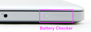

On the side is a battery checker when you press the button how many Green LED’s are lit and are they steady or blinking?

6 Green LED’s are lit and they are steady.
I doubt to the battery connector pins , because I tried to fix the first pins on the left of the battery connector , which it did
Well this proves the Battery is charged and the charging logic is working which tends to be one of the first things that's goes.
