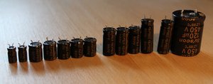

Almost the same symptom on my oppo bdp-93: after pressing the Power button the player freezes. The red led goes off (the light of blue led did not show) and nothing was displayed on the front panel. Tried to open tray by remote or local button (also tried to reset the display settings) but nothing happened.
Solved by replacing all the capacitors in power supply board. To my surprise the original capacitors were from SusCon and Acon (see photo).
The values of capacitors: 1 x 120 uF/450V ; 2 x 2200 uF/16V; 3 x 470uF/35V ; 5 x 220uF/35V; 2 x 100uF/25V.
I think more and more Oppo bdp-93 players will start to fail because of these old caps.
Thanks but mine powers up fine it is just that it freezes part way through the boot process.
With pleasure. However, I was also misled too: I thought it was a problem in the boot stage because after player freezes of approx. 20-25 minutes it starts to displays HELLO and works well. After unplug the player from the power outlet and reconnect it the same freeze appeared again on cold start.
After wasting a lot of time with the investigation, I solved the problem by replacing the capacitors. The player was manufactured in 2011 and these Chinese capacitors starts to fail. It is a normal process.
