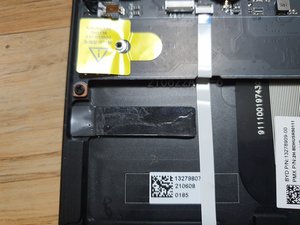

Razer blade 15 2020 (advanced) Battery is stuck or glued
The First image (Right) side flipped upside down. The second image is the (left) side flipped upside down.
Now, the screws are out and the cable is disconnected.
The puffy side of the battery is stuck/glued onto something.
How do I retrieve the battery? Its thicker than my laptop I NEED to remove it. How do I figure this out?
Thanks for any help!
(Images may swap because of the website interface)
Update (10/29/2021)
Third video
https://youtu.be/_Asb2daL-zM
My suggestion qould be to drip some Isopropyl (Rubbing) alcohol below the battery. This should soften the adhesive.
Thanks man I'll try. I can barely get the puffy side to give me a quarter inch.
If its not screwed in or anchored to anything else I'm not too worried about it.
I will infact rip this pos out.
Hi @kharmas_token ,
Looking at this video it doesn’t appear that the battery is glued down as there is no residual glue etc showing where the battery had been situated once it was removed. It was lifted straight out. Maybe because it is swollen it has jammed in position.
View from about 2:36 minutes into the video.
See if you can lever it out without damaging anything, especially the battery.
I swear I'm not crazy ?? I appreciate the response! https://youtu.be/jtc5UD01LaE
I found this answer in the comments of a YouTube video. Reposting for awareness. Thanks YouTuber Chad Garrett for this:
"There is a pull tab to the left edge of the battery. It looks like part of the frame but if you can lift it, just pull it straight out - it will come out as one piece."
This worked perfectly for me. :)
Hey I had the same issue- if you look to the left of the battery- there should be a little cave in for a black tag. You can try to get needle nose pliers to pull that up: it should look like it is stretching and about to break. I pried the battery out from the other side and it turns out that is an adhesive used to keep the battery stay in place.
FYI- just found this out today :) was in process of trying to remove whole board and was like this should be this hard.
I found why. It has glue sticker under the battery.
Also battery design is little bit different.
There is no screw hole at left upper side of battery pack. (Old one has it)
So, there has glue sticker for hold battery stronger.
