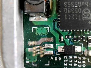

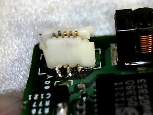

Ok, here my contribution.
After getting the message "Please Wait -Very Low Battery." I wanted to replace the battery of my iPod Video 5th 30GB, I broke the battery "brown connector" (it was already damaged, hence the message). It was completely ripped off of the PCB, the motherboard, including the solder paths! I could see some very small cupper dots. From these points I started with a multimeter with the Beeping (continuity test) function to trace the paths of the connections, since I couldn't find any diagram schematics on the internet. There are 5 pins, I labeled them for myself by numbers (1,2,3,4 and 5). By measuring I found that there are actually only 3 "main" pins, 1-2, 3 and 4-5. I soldered these points to the battery connector and hot glued it back to the PCB. And now it's working!

I am so glade I found your post. I had the same problem and worse rip and could not find the schematic. The rip is so bad that I can't figure out how the trace goes. I have exactly the same model and now I can use your info. Thanks a lot!!!

@Wolfson. Great detective work my Man :) I ripped one pin of the battery connector from the board and so I appreciate you tracing out where the pins go to as I may be able to superglue that one pin to the board and run a fine magnet wire to where you kindly showed me it goes. I will give it a try over the Christmas holidays and report back with my progress good or bad. We appreciate the time that you took to do this and them thoroughly document it so well complete with many photos. You are a good Ifixit member Image hear seeing as I cannot see how to upload images here https://imgur.com/a/ruxWgtt

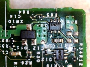

Thanks again @Wolfson I managed to run a jumper after removing the battery connector and resoldering it to the PCB. Worked like a charm as the two that were ripped off the board were both ground connections Image of repair here and I owe you a beer :) https://imgur.com/yNCu5Hv
GND jumper wire connecting two pins and then to GND of IC on other side of board
GND pin on IC on other side of board
