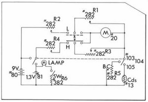

I’m trying to fix a Pentax Spotmeter V light meter, an analog device that is at least 50 years old, and I’m looking for any information on schematics or parts that can help me out. Maybe there is someone trying to do the same as me or has the info I’m looking for?

Before we had SMT devices we had small wired devices which someone would hand solder to a board. This is a micro resistor used in cameras and photography meters.
Pentax never offered a full schematic for the meter. But they did offer the analog side which you’ll find in the manual I posted in your other question.
Be careful! The wire legs are easy to snap off. The resistor is part of a voltage divider used to adjust the voltage of the sensor.

It is possible it is a voltage divider, but it is also placed before the sub-circuit of the lamp, so I'm not sure this adjusts the voltage of the sensor. Probably the voltage to the lamp then?

And while I'm saying this, I notice that Butkus put a circuit diagram of the spotmeter 1/21 on his site.https://www.cameramanuals.org/flashes_me...

@chris_ifix just thought of something after I have checked the schematic that you linked to on here and rereading what you said here ” But the light of the lamp is now so faint” which seemed to be a power issue. That particular diagram shows a battery voltage of 9.6V so that would then again be for a different version.
The circuitry and work-arounds are discussed in more detail on here
Check the schematic and you’ll see that is shows a resistor at R6 #382 and a capacitor at #81. I don’t think your part is a (micro)resistor but a capacitor. If you have a capacitance meter check it out with that . You know from the schematics that it is a 1.3V cap
