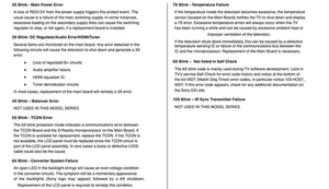

Tv turns off and make 4 red light blinks
When I turn on my TV, after 10 seconds it turns off and started blinking red light 4 times.
I heard it a power board problem, and I changed it by buying a new one from ebay.
But I still have the same problem.
Hope someone can help me with that.
Hi,
I found this in the service manual for your tv online
https://servlib.com/sony/tv/kdl-32ex655-...
Give this a read and see if you can narrow it down. It would also help if you could take pictures of the circuit boards and post them here.
Indeed my tv is kdl40ex725
