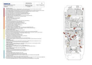

Seijo Coku here is the official Nokia troubleshooting flowchart for your phone. Of course, this will only be pertinent if your settings are okay and audio is turned on.
