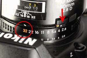

what I have found is you need to ensure that the lens is attached to the camera correctly. This error message will appear if the lens is not attached correctly to the camera or if you are not using a CPU lens Alternatively, if the lens has an aperture ring, it may not be set to f22 (or the highest aperture number on the aperture ring - normally marked in orange). Select the aperture number marked in orange on the lens and lock it using the aperture locking switch to prevent this occurring again.
Set to F22, or the highest aperture number normally marked in orange. Note the locking switch.

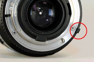

Check that the EE servo coupling highlighted on the lens has not been broken.

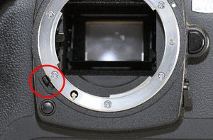

Check that the F-min switch highlighted on the camera body has not been broken.
