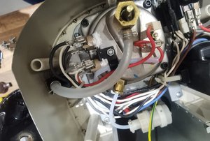

I dismantled the machine to check all the hoses. Nothing slipped or popped out anywhere, everything seemed fine. I took out the little tube that goes from the top of the pump (anti drip valve) into the boiler. The O-Rings seemed fine, the tube had no damage or signs of leakage. Also the hoses coming from the watertank seemed fine. No visible damage. Pump seemed fine too.
I put everything back together, open this time. I let the machine heat the water up, my steam valve was open so lots of steam came out there at first - I closed it, but then it started steaming out of the anti drip valve? It seems the hot water is going back from the boiler into the top of the pump, rather than down into the coffee dispenser?

After I checked all that and it seemed fine, I turned the machine back on again with open top (careful of any electrical contacts!!!). Then I saw that water and steam came out of the anti drip valve. It seemed the water got sucked into the pump, pumped into the boiler, heated up there and put to 15 bar, but because the valve was broken the water didnt actually came out but searched the easiest way, which was the broken valve, that regulates the pressure. I went on a site for delonghi spare parts, bought a new valve for £5, replaced the old one and -tadaaaa! It works again!

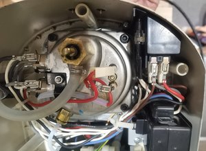

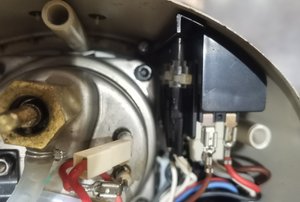

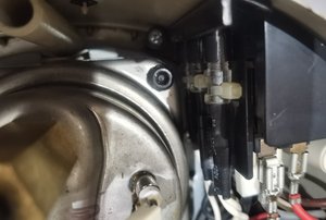

Hopefully these photos show what you need to see when mine did the same it was leaking from the clear pipe at the top
