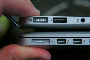

Often the contacts and insulator area is dirty
Make sure your’s look like the bottom one in this image
Otherwise the MacBook Pro 13" Retina (Late 2013-Early 2015) MagSafe 2 DC-In Board maybe bad. I would also inspect the logic board connections from the DC-In Board our corrosion on the middle contact as thats the one wire comm link to the charger. Here’s the guide MacBook Pro 13" Retina Display Late 2013 MagSafe DC-In Board Replacement
