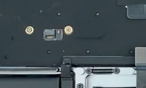

Likely the ribbon cable connection to the case needs to be checked, use a magnifier to inspect the ribbon contacts are not damaged. Also make sure to carefully lift the clamp bar to release the tension on the ribbon and make sure to fold it back down to set the clamp bar down when you’ve put the ribbon cable back in. Here’s a picture with the clamp in the up position.
I checked, all seems fine, I also just replaced the fan for a new one and the problem is still there.
@midge218 - The signals then find there way to the logic board via the MacBook Pro 15" Retina (Late 2016-2017) Keyboard Cable Check both ends and the connector pins on the logic board one maybe damaged.
