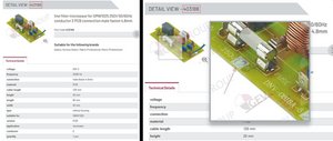

According to this link (search for DNV-0818A in the catalogue), a DNV-0818A-5 has a GEV part number of 403188
When zooming in it shows that the fuse is a 250V 12A. (see image below)
There is no mention of T or S (timed or slow - means the same thing) on the board’s fuse rating so it must be a standard fuse i.e fast acting.

Hi jayeff, closer examination of my original fuse link end cap shows it is 8 Amp.
I have owned this m/w from new so this fuse is original. I can only assume that these circuit boards are used in a variety of products and may have different ratings of fuse fitted depending on their use.
After more difficulty finding 32mm fuses, I finally laid my hands on some slow blow thermals. Although only 5 Amp, I wasn't concerned at using them as with a lower curent rating they would readily blow if there was indeed a fault elsewhere in the device.
