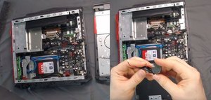

If still no good then you may have to turn off the PC and disconnect the power cord from the PSU and also open the desktop and disconnect the cmos battery from the motherboard and then press the Power on button for a full 30 seconds. Then replace the cmos battery, reassemble the desktop, reconnect the power and then turn on and check etc.
Here’s a video that may help with opening the desktop as this video which shows the cmos battery isn’t that good at showing this.
Here’s a composite image taken from the 2nd video showing the location of the cmos battery and where it is plugged into the motherboard.
(click on image to enlarge for better viewing)
If still no good then you may have to contact Asus as I don’t know how to reflash the BIOS if it is corrupted that much
