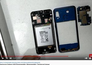

vibration on my phone isn't working.
May phone samsung galaxy a30 not working vibrate please 😢 halp
How can i fix step by step

If still no good, perhaps the vibration motor is loose or faulty.
Here’s an image taken from a teardown video for the phone showing the location of the vibration motor, that may help, (supplier example only to show part and what it may cost).
(click on image to enlarge for better viewing)
If the vibrate motor is faulty there are other suppliers online that may suit you better. Just search for Galaxy A30 vibration motor to get results
