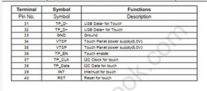

To the best of my knowledge a touchscreen uses ~10 wires in a 40 wire eDP cable. The image below is an example only and may not apply in your case but the point I’m trying to make is that if there is a hardware problem in the touchscreen e.g. X and Y axis can’t be extended far enough then the data can’t be sent to the motherboard on the USB data wires from the touchscreen controller in the screen assembly.
(click on image to enlarge for better viewing)
If you can’t find specific drivers for the touchscreen, and if the original still worked before replacement, then you may have to replace the screen to find out if the problem is in the display assembly or back in the motherboard.
