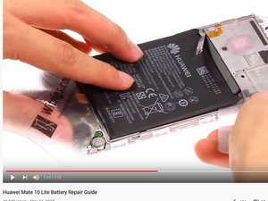

The model number shown for the Ifixit battery that you linked is HB436486ECW (printed on battery)
The model number of the battery in a Huawei Mate 10 Lite as seen in this video is HB356687ECW - see image taken from video.
They have different dimensions and capacities and I don’t know if they have the same pin out connections in the battery cable.
Mate 10 battery dimensions = 4.3mm x 64mm x 86mm, rated capacity 3900mA
Mate 10 Lite battery dimensions = 3.5mm x 66mm x 87mm, rated capacity 3240mA (actual capacity 3340mA)
