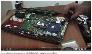

Hi Is it possible to have my laptop repaired if the Graphics card and/or Mother Board are deemed to be gone, on my MSI GE62 6QD??
Hi,
The GPU chip is hard mounted on the motherboard so if it is faulty replacing the chip is very difficult without the proper tools and skills.
Here’s an image taken from a video showing the CPU and GPU mounted on the motherboard in a MSI GE62 series laptop
(click on image to enlarge for better viewing)
If the motherboard is faulty then having the schematics for the motherboard will definitely help in finding out what the problem is but it may depend on what the problem is, whether it can be fixed and then whether it is economically viable to do so. Contact a reputable, professional laptop repair service and ask for a quote.
Replacing the motherboard would be the easier and perhaps cheaper option.
