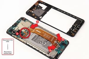

So i dropped my phone. And its broken, when i turn it on it just make a small signal and turns off. I want to repair the phone by myself. Do i need to change the whole display or can i just change the screen? Or do i need to repair it another way?

@sebbialsvik going by your description I advise that you change the complete display assembly. Easiest of all the other options even so it is not an easy task in general. This Video should help you with the task https://www.youtube.com/watch?v=qj8zk57D...

I am certain that it would. The flash of light is probably just the screen getting electrically excited but is to broken to turn on.

This is a common issue with the A21S, if you can see an image for a split second or it’s flashing on and off, disassemble the phone from the rear using hot air or fan, take the backplate off, remove the battery and remove the LCD flex cable, reconnect the flex cable back and then the battery, if the screen is not damaged it should work fine. This happens because the LCD flex cable gets slightly disconnected from the FPC connector.
