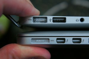

2nd-generation magnetic AC power adapter for MacBook products, first released in 2012. Not compatible with previous generation systems. Available in 45W, 60W, and 85W versions.

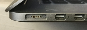

Been a while ago, my all electrical devices burnt because power surge that I lived, fortunately I repaired all devices except magsafe 2 45 watt, I replaced all broken power components of magsafe 2 (capacitor, varistor, fuse and inductor) then I connected 39k ohm resistor to output pins (0.6v without connecting 39k ohm) and I saw 15v on output, It worked technically and charged my MacBook as well but sometimes light turns off suddenly and charging stops, after unplugging cable and plugging it again, It starts charging again but not for long, I can't estimate what's wrong with it, thanks in advance.

Use a cotton swab (Q-Tip) with some 75 % or better isopropyl alcohol and if needed use a fresh (soft) pink pencil eraser to polish the contact surface rolling it in your fingers as you press down.
Make sure the white insulated area is also clean as the piled up junk can mess up the ability of the contacts to make a good connection.
Use a cotton swab (Q-Tip) with a bit of kitchen cleaner to get rid of the junk

I cleaned the port and reset SMC as well, but nothing changed. I desoldered magsafe 2 cable and connected it to my safe 14.85 volt power supply and It charged quite well, never stopped untill %100. But when I connect cable to magsafe2 again, It sometimes turns off untill plugging it again.
Looks like you need both a new MagSafe charger as well as the DC-In Board or I/O Board depending on which system you have. Which is ???
I have Intel based MacBook air 13" 2017. Looks like you're right mister Dan, need a magsafe 2. I have to look used one as a student, but I keep trying to repair broken one to share
