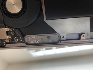

I had the same problem with 2 Macs, the solution was to clean the grille with a dry/clean toothbrush. The issue was that the micro-holes were blocked, which can be confirmed by passing light through them.
I could diagnose the problem by connecting the speaker without installing it, I leave it carefully hanging and it sound really loud.
I attach a photo of the blocked micro-holes.
@oliversi - To many bread crumbs! 😆
it acted more like a cheese grater :)
