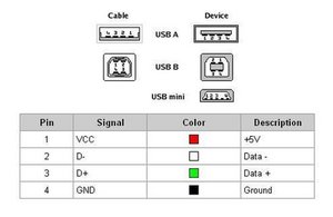

Have you checked that it is the mouse that is the problem and not the USB port that the mouse is connected to, you didn’t say?
Try plugging the mouse into another known working USB port and check if the laser light turns on or not.
If it doesn’t then you may have to open the mouse and using an Ohmmeter, check that there is continuity for the power wires (Vcc and GND) in the mouse cable between the plug and the mouse.
Here’s an image showing the standard pin and wire colours for USB cables/plugs that may help
(click on image to enlarge for better viewing).
