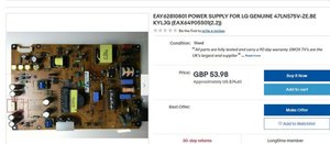

Hi @jackem ,
Before you try to find a LCD panel (which may not be that easy to find or if you do then the price is not worth it) did you check the voltage to the LEDs from the power board?
I’m not quite sure where you meant that the 24V was fine, the power board connector to the mainboard or the LED power connector. I’m not sure if there is 24V to the LEDs though so set your Voltmeter to the highest measurement scale as a safeguard and then lower the scale to suit for more accuracy.
Here’s an image of the power board (hopefully yours is the same) where I’ve highlighted where I think that the LED connector is. It is a bit hard to see but maybe there are pins on the connector that are marked LED+ and LED-. If you measure between the LED+ and an Earth point (a screwhead on the board should be earthed to the chassis) you should get a reading.
(click on image to enlarge for better viewing)
Also it may be worth investing in a backlight tester and testing the LEDs first, as it will be a lot cheaper than a panel and if it is the power board and not the panel, then both i.e. power board and tester would still be cheaper than a panel.
Maybe by using the tester you’ll find that it is the LED strips themselves that are the problem. (supplier example only)
There are videos on YouTube that describe how to replace the LED strips in a TV but make sure that you find one for your model (or very close) as a panel comprises diffuser sheets as well so you have to know how to dis-assemble it so that you re-assemble it correctly. Either that or take pictures as you dis-assemble ;-)
