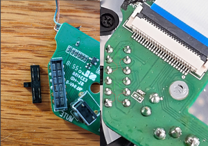

Hello,
I have the following problem with the headset:
The sound is sometimes very inconsistent. Example on a music track, I hear the music consistent but distorted, but the singing partly not and when it does as if it were coming from a distance.
However, if I now wiggle the on/off lever, it fixes the problems as long as it is in a certain position.
Does anyone know the problem and how to fix this?

Hi,
I had the same issue and I fixed it by cleaning the connection of the switch. If you look at my picture you’ll see the dirt causing the issue. I’ve also linked the video I followed. Hope this help.
https://www.youtube.com/watch?v=9r8KK3yn...

@Solomon Salzman I just fixed mine today, following that video.. i used the iFixit bit "J00"
I used this for my g935's worked like a charm. Just a heads up though those little flat pins on the actual switch aren't glued in and are tiny so use caution when cleaning. thanks for the video!
This is the Fix for this problem, done it multiple times.

I can confirm this fix works.
I used fine tweezers to remove the switch cover, then used isopropyl alcohol, a cotton tip and a pointy plastic spudger to scratch off the dirt.

Same issue. Cleaned the switch, sprayed some dry ptfe lube on, bent the metal strip so it tensions down a bit more on the slider and wham bam it works like a charm.
No more smacking the thing like a mad man XD.
I used the guide from @alexandrec11706 but messed up and the power switch went flying across my desk because of carelessness. One of the 4 tiny metal contact points was lost. So I ended up soldering the contact points for the switch so that it is always turned on. PS: Remember to permanently remove the plastic switch if you go the solder route so it does not short. I've included a schematic of the contact points. Green Are the pegs you want to solder to keep the device in a permanent on state. Red is the off state.
