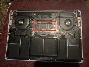

I cant find my ram location
Where is my ram located, I am having ram issues, 3 short beeps and no startup.
Hi @dannyb007 they were soldered onboard
@dannyb007 - Time to find your way to someone with micro-soldering skills to fix your logic board.
