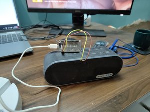

I opened my srs-x2
removed the old battery
I put 5V in the old battery terminal and tried to turn on the srs-x2.
no success.
closed the srs-x2 without the battery, but with the circuit board that has 7wires (3 red, 3 black, 1 white) which was attached to the battery.
now the srs-x2 is working with no battery and pluged in the usb.

I have the same model and thought of the same resolution. What I did is i used a old circuit board that was USB (5V) plug in and various ports gave 3.3 output. I tried to connect the 3.3V to the 3.7V points and it works. (has a very minor bug that I need to give some power to start the system and then all the functions work fine)
Any better solutions welcomed! :)
