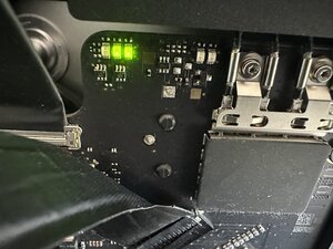

I’m working on a customer’s iMac 2019 for a no-power issue. She stated it was rarely used for the first year and a half she had it and just recently started using it for remote work. I can’t imagine that she could have done anything to it to cause an issue. She even had the original box, foam, dust cover, everything. One day, she went to turn it on, and nothing happened. No fans, no chime, just a bit of an initial whine from the PSU capacitors when it’s plugged in.
After checking the diagnostic LED’s on the logic board, *only* LED #2 is lit. LED 1 would indicate trickle power and LED 1 + LED 2 would indicate the system is on and receiving enough power. Never, though, have I only seen LED 2 on with LED 1 off. I checked the diagnostic guide for this iMac and nothing in the troubleshooting section says anything about an LED being on “out of sequence” of the prior prerequisite LED’s.

I had the same problem and fixed it finally.
For me, I found that one of my CPU pins was bended after checking all the components. I fixed the CPU pins problem and my iMac was work again.

In my case, I’ve somehow managed to tighten the cpu bracket bolts too much (maybe I failed the criss-cross method somehow) and as a result I had bent the actual cpu base. Once I noticed this - I’ve applied force to try and straighten it out and after that really carefully tighten the cpu bracket.
It works now!
Hopefully nobody will get into this situation again, but hope this will help, if you do.
Exactly same issue with no pwr and only 2nd led lights fixed.. It could be various reasons, like some dirt, residuum from old termo compound, dust, banded corners of CPU etc. Anyway just check the socket or cpu. There it should be ..
I have the same problem. I removed the screen and tried to turn it on. It turns on, but LED1 does not light up; only LED2 and LED3 have a green light. Any ideas?
In my case it was not properly aligned CPU - I had to dismantle heatsink, replace the TIM and mount it back with proper order of thightening of the screws.
