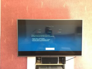

Top half of screen is dark
Top half of the screen keeps going dark, and have little bright shadow on the screen
Hi Mark, I have a Samsung UE50JU6800 that has just developed the same issue.
Whilst i dont have a definitive answer yet, i found a video from Shivamm Rane on youtube ( a search on Youtube will find it, unsure of iFixits rules on links ) that details replacing either the entire LED light strips or individual LEDs on Samsung TV’s that cause this issue. It will be a few weeks before i attempt my repair but hope this helps you on your way.

U mnie jest na odwrót na dole jest ciemniejszy ekran
@szmondjabin in that case your bottom backlight strip has failed. Replacing it should fix that.
