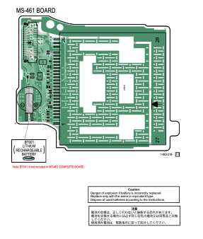

Here’s an image showing the location of the backup battery Sony part #1-756-813-11 (supplier example only), taken from p.18 of the service manual for the camera
(click on image to enlarge for better viewing)
The manual details how to dis-assemble the camera and it appears that the battery is soldered onto the MS-461 board. (Sony part #A-1818-410-A - I can’t find an image of the board which would help but once you have accessed it the battery would be quite obvious)
I only found a few supplier listings when using the part number to search online for the battery. You may have better luck.
Hopefully this is of some help.

From the service manual it looks as if it is clipped to the MS461 board, not soldered, and is not supplied with the board so must be available separately.

Hi. I have dismantled two cameras. The battery is definitely soldered to the board. As to supply I was not able to find any suppliers here in Australia. I suspect that is was a "one off" that was made specifically for this camera, but in the U.S.A you may have better luck. Even if I could obtain a battery from the "states" the shipping/postage is so high as to render the project nonviable..

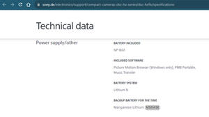

I am not sure if this will be helpful for some but I found this on a Sony archive.
The battery can be found by looking for MS614SE. Have not tried it yet but seems to be the same one shown in the manual.
