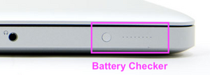

With the computer open and sitting on a table in from of you, look at the left hand side of the top case (the component which houses the keyboard and trackpad). You should see a small gray button with about 8 perforated holes next to it. Press that small gray button. Do the perforated holes light up? If so, how many lights does it show? (This indicates the charge of the battery and can help us determine whether or not the battery is completely drained).

On the Left side is your systems battery checker
With the charger disconnected what happens when you press the button? Do you see the small 10 LED’s? Are only a few lit? Are they blinking?

Nothing. No light light up when I push that button.
Time to replace the battery! MacBook Unibody (A1278) Battery. You also may need a new MacBook Unibody (A1278) Battery Connector as the contacts often failed on them.
