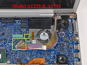

In the picture attached there is a connector in the largest of the two yellow rectangles that I am afraid to remove without further instruction. Does anyone recognize the connector and know how to remove it? I need to remove it because I am in the process of replacing the right side fan, and the wires are in the way. Thank you.
click on the image to zoom it
This should do it!
Dan, thank you so much. Excellent graphics.
