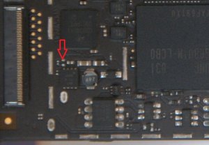

Ok here's an overview of what was wrong with my ipad...
This image is of a scrap board I had which I've removed the metal screening from. The red circle indicates the position of the short circuit capacitor (It's already been removed from the board in the pciture). Note this is the underside of the circuit board (i.e. that the side that's face down).
Its easy to check with a meter, if its short circuit then this is you problem.
This second picture shows the output from the LED drive circuit, the arrow indicates the point to test with a volt meter to confirm that the fault isn't with the voltage part of the circuit (The voltage should be around 18volts). You should be able to test this in place (you don't need to connect either the digitiser or LCD to check it), my tip is to use some pins soldered to your probes to make it easier to test.
This is the topside of the circuit board, you should be able to access this whilst the circuit board is installed in the ipad.

Have just fixed an ipad with no backlight. After much work I tracked the fault to a short circuit capacitor on the logic board this held one of the gate inputs to a mosfet low and hence turned off the backlight driver circuit. I also have figured out most of the circuit for driving the LED backlight.

I have added a new answer below with pictures, hope this helps.

Sorry , is soldered! remove this and re- solder new 4R7 !!! ;)
cheers
Andrea
4R7 is magnetic type components, you should not have major problems in replacing just a little bit of forethought to remove it.
If you have a micro soldering or otherwise you can find it and have good manual you can do it without problems, unsoldering the base component and only after removing it.
I could let you but from what I see are very far from you. I live in Italy even though I live in the us and make this work: ((
replacing 4R7 is not an easy job. It's not a job with soldering iron and removing chit out and in. I repair iphones professionally and I even get nervous when I have to remove such and 6R8 on 3Gs.
If you want to get an experience with a chance of sacrificing your board, try it, otherwise look for a professional.

iPad2 Backlight chip is located here. This is the one you need to replace to get it working. I tried replacing the chips on the pix in this thread above, but didn't work.
ipad2 backlight chip location

check the back light voltage on the back light power diode aprox 16 volt.
this is missing in set. ...get only 3.7v .. as per battery

the backlight chip
and the backlight filter
and then if you ipad had water damage change the backlight 4R7 coil as well.
for more detailed picture showing where the ipad 1, 2, 3 backlight circuits is located please visit http://www.cyberdocllc.com/ipad-2/
I have fixed more than 20 ipad 2 logicboards with backlight issues so far. I havent have one fail with this solution just by changing these three surface mount components.

I have repaired these, and as far as I can see you DO NOT need to replace 4R7. Just the other components. Yu can get them inexpensive here. parts

If your ipad 2 was dropped, there is the possibility that the backlight chip on motherboard is broken. I've had the same problem with mine and solved it with a little trick without spending a buck (and without soldering)...check the video, hope it helps :)

There are a few techs on ebay who repair this problem. It requires micro soldering of one to 3 components. You must disconnect power from motherboard before you pull off the LCD connector. When reassembling, you screw down motherboard last. Otherwise you sent s spark through the circuit.

*****PROBLEM SOLVED****** hello everybody i had the same problem after replacing the glass no back light i connected the i pad to my computer back everything up and restore it and the lcd start working again.
i dont know where diode please give me the picture to remove or change..
yes, if you have a known good LCD installed, then you need to replace your backlight diode.
Hey if you guys need to know where the diode and backlight filter are, we provide a free diagram for installation along with our kits. [Spam]

The reason why that little diode is important is that with the 4R7 coil it makes a boost converter that steps up voltage to 16.5 volts for the series string of LEDs and then another component regulates the current to provide brightness adjustment.
