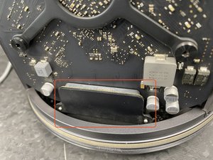

I have an MacPro6,1, the 2013 year model which has the kernel_task going to 900% and fans at full speed. I’ve run the diagnostics tool and it came up with the following two errors:
• PFM006 - There may be an issue with the System Management Controller (SMC)
• PPM001 - There may be an issue with the power management system
The mac powers on fine, but is extremely slow. The SSD is cleared so no software is installed, running from Big Sur from an USB is also really slow.
I’ve opened up the machine and there was a lot of dust. Cleaned out a lot and have put it back together. No change. The water indicators I’ve seen on the boards are not red, hence there is no liquid damage from what I can see. Nor can I see anything weird on the open sides of the boards.
I’ve also done the SMC reset, didn’t help either.
I got the 6 core D500 model with 16gb ram. It also has some HDMI issues from time to time, having the screen flicker (like it’s not getting a propper connection); however using thunderbolt > HDMI works fine.
Does anybody know what I can do to resolve this issue? Do I need to replace the backpanel/PSU, or is there another issue which I can look at?

Did you check the cable which I posted on Oct 13, 2022 in this topic?
It looks like this cable can become loose over the years. Check that it is firmly in place. The cable can look like it's properly connected, but if you give it a push you may find it connects tighter.
I think I may have figured this out. It turns out my MacPro 2013 had a loose Mainboard cable. Make sure yours isn't loose. Attached is a photo.
I didn't connect the same problem with the fact that yes I had dropped my computer twice in the last 2 days. I got the same error codes. Open the back and started pressing boards back in and cable connectors in and I really don't know which one I hit but all the sudden the 250% kernel task and super fan mode stopped.
Everything's working peachy. This has nothing to do with Clean My Mac or software... The fact that happened right after a software update let me believe it was a software problem but...nope.
Some connector was unseated.
Lose cable was my problem. I thought my Mac Pro was dead. Thanks a lot!

Replaced the screen. Has the same codes. Webcam cable by the fan was culprit. Tested webcam of the broken screen and all is good. Now i need another screen and return this one.
I had a cable/ribbon loose. It is one the connects around the fan. Reconnecting sent the Kernel from 250% down to regular levels. If the image shows, my fingers are on both connections of the ribbon, it didn't appear loose at first, but clicked into place, then regulated itself
