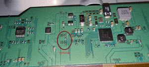

had the same problem, remove 2 smd resitor and mine was fixed.
if u have the one with 4 resistor and the rt6820a just remove the 2 ones that are vertical farther away from the controller.
I had the same problem, I removed 2 smd resistors and mine didn't resolve, there are still horizontal stripes at the bottom of the screen, of course until it warms up, then it's ok, maybe some idea
