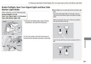

Back up and turn signals on my 2013 Honda Civic 4 dr sedan are simple twist and insert bulb procedures. The brake light is different. Not clear how it is removed and replace.
Hi @edessex13 ,
Here’s an image taken from p.291 of the owner manual for the vehicle.
It appears that the brake/taillight bulb comes out the same way as the turn and back up bulbs. Rotate the socket to the left to remove it from the housing and then pull out the bulb.
Perhaps the brake light socket is just stiff and it may need a bit more of an effort.
(click on image to enlarge for better viewing)
