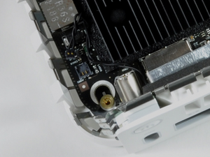

This Mini is the second device where a connector has come off and disabled the whole unit. I can see the two posts on this Mini where the connector broke off. Now I have to raise them or extend them so I have access to solder them back to the power button.
Solder isn’t holding to the nubs of the two wires that went into the traces. Plus it’s almost mcro-micro-soldering. I’m hoping my post here will get some comments about how it might be done.

The power button on the mini doesn't close a circuit permanently, just enough to start up. What I really need are the schematics so I can solder elsewhere.
Hope these photos are ok. Best I could do. You can barely see the really tiny grey spots. Since I don't have schematics I'm guessing the two on the bottom are the pair I need.
Ouch! Not the best images but I think I see enough to know you have nothing left on the pads the tan area is the bare board not the copper pads which is why solder won’t stick.
Here’s a better view of the area
Apple as far as I know never offered schematics or board views of the Mac Mini series. So finding another location to tap will be difficult without having a reference board which at that point you might as well just replace the logic board. Here’s one source for the replacement logic board TheBookYard UK - Early/Late 2009 Mac Mini Logic Boards

The repair question remains. There are points I cqan tell either connect a component or were where the original connector was. But they are flush with the board. Any soldering I've tried won't take.
How can you solder to a flush level point on the board ? Be it a trace (copper) or hole. There has to be a way to connect a wire to those points.
As bizarre as it sounds, I could get a dremel tool, make a hole and run a hard point there then attach there. Come to think that's a good last ditch effort lol.m What's the name of a thin point/wire to put into the hole I drill ? Isn't there a real piece like that ?
Yes, it's randomly trying points, but what's the worsst that can happen ? It's already dead.
@capwalker666 - Sorry without knowing what the given trace is you're just assuming the line is correct. Drilling or cutting won't do either as again you would only end up damaging other lines.
Logic boards are like a multi layer cake! think of the frosting as copper foils that are sandwiched within the layers as well as on the top and bottom. But unlike our frosting model imagine you have lines of different color frosting in stripes going across and going in a wave! At some points the upper layer color and the one below are the same color and a "Via" hole was drilled and filled with a conductive wire or coating linking the two. Now I'm made a very small example of what a multi layer PCB is like in your mind Now think how difficult it would be to travel across the country by car without a map or any signage or even a compass it would be very difficult! Thats what we face here No idea where in the layers are or where they go!
Sadly, its time to get a new board there just isn't any way you can fix this.
