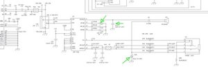

Hello everyone. I am at my wits end here trying to repair a special Pikachu edition of a Gameboy Color. I have read several articles saying this edition seems to have a lot of sound issues. So, these are the things that are working and not working and what I have replaced/tested.
Currently, there is no sound coming out of the main speaker. I replaced it with a brand new speaker (twice) and still no luck. I have conducted a conductivity test on the speaker itself (good), on the wires leading from the speaker to the motherboard (good), and on the motherboard solder joints (good).
I have tested the headphone jack. When headphones are plugged in, I do get sound from them. Spinning the volume control does increase and decrease the sound. Unplugged and no sound from the main speaker. Tested conductivity from the headphone disconnect to the motherboard and it’s good (so the speaker disconnect doesn’t appear to be stuck). Just to be sure, I plugged in and out a jack a dozen times just in case to loosen it. Still no sound.
I tested the original speaker that came with the Gameboy, it actually still has conductivity so it appears to be working fine. This Gameboy was stored for the past 10 - 12 years in a cardboard box in an outdoor garage. No water damage to the box but it was subjected to extreme conditions (-10 to -60 degree winters, 80 to 100 degree summers). No batteries were stored in the Gameboy so no erosion or acid damage. Before being placed into storage, the speaker worked fine. All other aspects of the Gameboy seem to be working just fine; no screen distortion, powers on and off fine, and plays any game put into it.
I can’t figure it out and it’s bugging me. Sure, I can play games with headphones on but I REALLY want sound from the main speaker. If I’m missing something, I can’t figure out what it is. Any help (besides buying a new GBC, hehe) would be helpful. Thank you.

Check that there is an earth at the SW test point on the circuit board (goes to pin #6 U3 IC) when there are no headphones inserted.
I realize that you said that you “Tested conductivity from the headphone disconnect to the motherboard and it’s good (so the speaker disconnect doesn’t appear to be stuck).” but I wasn’t sure whether you tested it back all the way to the IC.
If it tests OK then here’s an image taken from the service manual for a Game Boy Colour showing the audio section. Hopefully it is the same for your edition.
(click on image to enlarge for better viewing)
Some things to check and do to try and isolate the problem:
Check that the capacitors marked with the green arrows are OK and not either open circuit or short circuit. For example if C38 was open circuit there would be no audio through the speaker. If C14 were short circuit it would shunt the audio from going through the speaker and if C27 were faulty it would affect how the audio amp for the speaker in the IC would function (there are two amps in the IC, one for the headphones and one for the speaker).
Unsolder the non earth side of the C14 capacitor so that it is no longer connected to the board and check if there is audio. If there is then C14 is faulty, replace it
Tap a wire from earth to the A-GND terminal that the speaker is connected to and check if there is audio. If so then the C38 capacitor is faulty, replace it
Replace the C27 capacitor and check.
If still no good you may have to replace the U3 IC audio amp.

Earth = Ground The terms are interchangeable and mean exactly the same thing.
C14 would have to be removed if is is an smd component (surface mount device) and then you could test it "out of circuit" with a Ohmmeter and it should test OL or open circuit as capacitors are open circuit to DC but not to AC. Audio signals are effectively an AC signal and not a DC signal
If you solder a wire from the side of C38 that goes to the earth connection NOT the side that goes to the speaker terminal (A-GND) and then solder the other end it to the AGND speaker terminal i.e it bypasses the capacitor - side that would normally connect to C38) and then try for audio and it works then the C38 capacitor is faulty because it should pass the AC audio signal that comes from the audio amp, through the speaker and then to gnd. You could always simply short out the C38 capacitor and then also try it.
I think that AGND is the manufacturer's schematic reference for the ground side of the speaker AGND = Audio ground perhaps idk.
The capacitor is only used to isolate the earth which would go through the speaker to the amp for DC currents which may affect the back end of the amp.
If still no good connect one test probe from your Ohmmeter between pin 3 of U3 IC chip and the other meter probe to the speaker terminals one at a time you should see continuity to and then through the speaker. Always disconnect the power from the board when using an Ohmmeter.

@jayeff thank you so much. Your advice has really helped me a ton. I had a similar issue and did every bit of cleaning the headphone jack, to replacing the speaker, to replacing the capacitors, to taking off C14, and etc. After doing those, I found out that the SP and AGND were not getting any voltage at all.
But thanks to your schematic I was able to figure out that my board had no continuity with the SW in the U3 IC chip to AGND. So I bridged the connection with a wire and now the speakers work! I even installed an amp module to make it even louder. The only issue now is that I hear a very faint hiss but that's totally fine rather than not getting any audio at all. Thanks for the help again!

If there's no earth at the SW test point then there won't be any audio from the main speaker. It is electrically the same point that you're talking about. It's just a matter of finding out why it's not there. It could just as easily be a faulty inductor or a dry solder joint anywhere in that particular section of the circuit and not only the contact that is the problem.
As to the following checks I listed, I don't know how you go about finding faults in electronic devices but mine is to not assume that it is always the same cause every time, for the same devices exhibiting the same fault symptoms.
You have to treat each one as a new problem i.e. find out what works and what doesn't and then go from there.
Sure it can be that a lot of them do have the same cause but don't bet your house on it being the same every time, because one day you'll get caught out.
