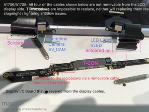

The case is that i have a macbook pro 13 with touchbar 2017 with the famous screen problems. Is the second time that i have problems with the screen. My first case was that i broke the lcd. In this time, after read a lot cases in the forum, i think the problem is that t-con board is cooked. I can see a lot of horizontal green and pink lines.
So here is my question: can I replace the cooked t-con board with the good condition t-com board from my old broken lcd?

Sorry its not possible! The T-CON is hardwired to the ribbon cables and then onto the LCD panel (fused to the glass panel via two ribbon cables). Review this image:
Photo credit: @just1ed www.macplus.sg
The purple ID’d connections are not accessible without damaging the cables.

The problem you have described here has nothing to do with t-con board it self. You have damaged LVDS flex cable. But first to answer your question - yes , you can swap T-Con board, but you need to get it with same modification/software version . As lcd screens has been made in different factories, has different COG (Chip-On-Glass) configurations and so on… To do that - there is a QR code sticker with letters/numbers on it. It describes what software setup has been installed on t-con board. Usually in our repair shop - we salvage them from broken screens .

First this series uses iDP signaling not LVDS! Apple took the T-CON out of the display moving it into he body and the cables are not replaceable. Review the image above.
@danj it is replaceable , thats what our business is basically living from - MacBook screen repairs, including new versions of macbooks , without losing True tone and other functions.

@emilludvigsson - Please fully read all of the answers and comments which dive into this a lot deeper. Replacing a given ribbon cable is not that simple! While one could find the backlight cable the needed work to open the display assembly and solder on the replacement is a lot harder and most people don't have the needed skills to do it. The display cables are even harder! And not available, this is where replacing the assembly is the better direction.
