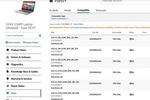

Looking at the parts list for a Lenovo S145 -15API (is this your model? found this by searching for Lenovo 81UT003WUS that you provided) there are two model variants, Type 81UT and Type 81V7. See the images below to view the Lenovo LCD part numbers (FRU) for all the various screen options.
Do any of the numbers match what is on the original screen or perhaps on the replacement especially in the Type 81UT model as there is a UT in the model number you posted?
I haven’t searched using the part number only to see what the actual screen was as I didn’t know which model variant you have.
(click on images to enlarge for better viewing)
Hopefully this is of some help

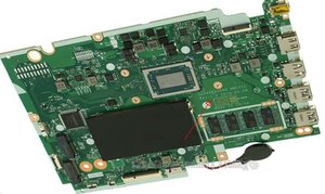

The number you posted is the Lenovo part number for the motherboard.
Using that number I found a board online and from it the board number i.e. GS440&GS540 NMC511 rev 1.0 2019-05-28 (See image below)
Verify that it is the same as yours
(click on image to enlarge for better viewing)
At the moment the only schematic (I think it is anyway and not something else related to the motherboard) I could find is here in the 1st post but you have to pay for it. You may have better luck finding one for free.

What is the motherboard board number?
@jayeff the motherboard number is 5B20S42804. I downloaded the datasheet for the panel they sent and the pinouts look to be the same.
@jayeff Yes that is the motherboard. I've searched by the number you provided and the Lenovo part number.I'llkeep looking but not having much luck.
