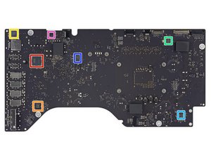

iMac Intel 21.5" Retina 4K Display 2015 Logic board

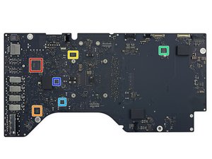

iMac Intel 21.5" Retina 4K Display 2017 Logic board

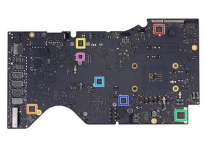

iMac Intel 21.5" Standard Retina Display 2015 & 2017 Logic board
Note the size differences in the top right metal connector that’s the displays data connector. There is a big difference between the interfaces! eDP on the 2015 model and iDP on the 2017 4K displays.
Kaellis who jumped into the dialog I think was confused! What I’m suspecting happened is he got confused between the Retina Vs 4K displays as both the ‘15 & ‘17 series offered a Retina model which as it turns out use the same display (older eDP)!
So if you have a 4K display you need to replace it with the correct one!
