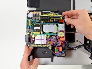

Hello, I started noticing a strong chemical smell coming from the bottom left air-vents of the Thunderbolt Display, but no other signs. The brightness is fine, it powers the MacBook, and no strange behavior. I ordered a PSU replacement, did I make the right choice? Should I also replace the FAN? (but I’m finding only used fans…)

@danj Thanks Dan, mine is different. Look at the photo, I marked what seems to originate the bad smell. Is still the component you mentioned before?

Without opening it up to inspect things it could be anything!
Hello Dan thanks, yes it could off course... but I didn't want to open it without first having something to swap, as I have fear for that delicate wires that need to be disconnected to separate the two monitor parts. I wanted to know if, based on experience, this smell could indicate a faulty PSU, as the fan itself shouldn't make burning smell (am I right?), and it pushes air through the PSU pub and then it gets out on the left air vent at the bottom
I've replaced more logic boards than PS on these monitors. A fan would not be the first thing I would suspect.
Thanks, so I need to open it and check every power rail I suppose? At this time not other sign of malfunctioning (unfortunately). I could keep in using it, but the only thing is I have fear the smell could be toxic.. what did you find on defective logic boards?
Burnt caps mostly

Here’s a marked up image of some of the of the major parts
