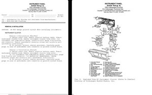

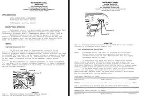

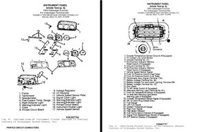

How do I reset the instrument panel on my VW T4
My instrument panel gauges are not reading properly how do i reset the instruments
I have a 1996 vw caravelle 1.9 petrol.
My instrument panel is playing up,
For anyone wherevi can buy a new one please ?
Hi @j0hannesdewit
Here are some images from the Instrument Panel section of the 1993 VW Eurovan repair manual that may help.
If the gauges are not reading correctly there may be a problem with the voltage regulator in the instrument cluster.
