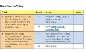

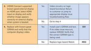

No Video
• No image.
Quick Check
1. Inquire which video port and cable is used by customer.
2. Check connectors and cables for pin damage.
3. Check both computer DisplayPort and HDMI connections with known-good displays.
4. (DisplayPort) If DisplayPort to DVI adapter cable is used in customer’s configuration, check it on a known-good computer
5. (HDMI) If issue only happens on customer’s HDMI display, make sure that he selected the correct AV input, that he connected directly the computer to display and that he is using known-good HDMI cable.
6. Reset SMC.
7. Go to Deep Dive.
