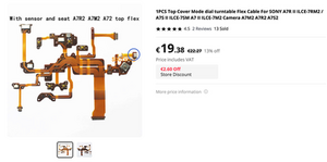

My camera buttons aren’t working.
the menu button, fn, select button don’t work.
the shutter release button works fine.
the camera isn’t very responsive in manual modes. It works fine in Auto mode.

I too have the same problem with the Sony A7R II... I wish this was an easy fix, looks like I'm going to look for a repair shop.
Sorry for the very late reply. Yup i got mine fixed with the local repair shop. They say this was an issue the with Sony A7II when passed the shutter count. Seen this issue also with my friend the same as mine. Both our units are now now functioning well and hopefully in the years to come.
I got mine fixed for USD65

We just did this repair here at our shop. Here's the part on AliExpress for anyone wanting it: https://www.aliexpress.us/item/325680230...
We have fixed the button issues, and all functions seem normal. We're proceeding with extensive QI at the moment before letting the customer know they're all set.
No one else in our area appeared willing to do the repair. Sony wanted $400 just to take in the camera, so we gave it a shot. It was a pain, but hopefully, it's all worth it.

Same problem here, with both my A7ii and my A7Rii. Both camera's are 7 years of age. I am currently in the proces of replacing the top button controls. With the help of YouTube and IFIXIT (thanks guy's for the clear teardown instruction). The buttons on the back I replaces as well, but that didn't solve my problem. The AliExpress delivery took four weeks.
Hi! I attempted the repair with the flex-cable on the top assembly, first only the arrow buttons were not working anymore, I was able to fix this issue BUT ended up breaking the menu button as you described and the adjustment wheels don't work anymore. I would advise against trying to repair it yourself as the repair is very cumbersome, many thin flex cables dangling around while having to remove bigger parts. Plus, I wouldn't say I'm inexperienced as I've already done multiple iPhone, an Apple Watch repair and some other random devices. Do it only if you're certain and you are fine risking to damage the device further during the repair. If you attempt it, plan in a lot of time, took me 3h just to get to the flex cable and if you run out of time or something doesn't work, take it very slow, because that's where I always make mistakes. :D
