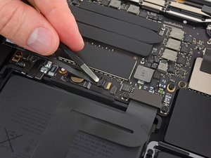

This weekend I replaced the battery in my MacBook Pro with a new ifixit battery. The MacBook had worked fine until recently, when it suddenly stated that the battery was not charging and needed replacing. Following on from this, it ran exceptionally slowly and would not boot at all at times.
I have replaced with a new battery, and it now turns on just fine (after an OS re-install), but is still saying that the battery is not charging. It now lists the following:
  • Fully charged: No
  • Charging: No
  • Full Charge Capacity (mAh): 4698
  • State of Charge (%): 1
  • Cycle Count: 0
Could it be the new battery has an issue? Any advice would be kindly received.

While you have some on the needed information I need to see a bit more to figure this out.
Let’s get a better view of things, install this gem of an app! CoconutBattery take a snapshot of the apps main window and post it here for us to see Adding images to an existing question
Hi Dan, have downloaded the app and added the image - hope this was what you needed to see
Update:
Followed up with ifixit support, who believe the replacement battery was faulty, so kindly sent out a new kit.
Have installed it today, and the mac is now working and charging properly :)
Could you have damaged the battery data cable or not fully secure it? I would start there
If that is in good order, I fear the charging logic needs to be investigated on the main logic board.

I will attempt disconnect and reconnect the battery cable. Do not believe it was damaged during disassembly or re-assembly, but it could be the cable itself as this does not come with the replacement battery (needed to use the old cable), and this is exactly the same error I had prior to changing the battery (could be the old battery was not actually the problem?)
I presume the screenshot shows that the new battery itself is absoutely fine?
If it is the cable, I will order a new one and see if this resolves. Out of interest, what are the next steps to investigating the charging logic on the main logic board?
@Richard Crampton - The CoconutBattery results is perplexing!
Some of the data which comes from the onboard micro controller within the battery (the little logic board attached to it) is finding its way to the SMC services (Like the temp 19.3℃). But for some reason the current charge is zero!
I would start off replacing the cable and then see where you are. If that didn't alter things then its something within the logic board charging logic.
@danj thanks for the feedback. Interestingly, CoconutBattery is also reporting that the new battery is 1,281 days old - would that be correct? Not sure if the batteries fixit sell as part of the kit are refurbished (which would make sense), or if this could be related...
