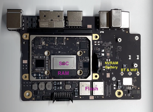

Nope! It is what you buy, no internal upgrades possible!
See for your self! Everything is soldered.

Thank you for showing us that photo. Helped me decide not to buy- my kid can run Linux instead.
There's a video on YouTube by Luke Miani; Upgrading an M1 Mac mini SSD from 256GB to 2TB. Only for the brave ones, you have to know what you're doing.
As the trend goes with Apple products, all “smart” parts are serial-paired and possibly encrypted. Swapping original parts may not work, not to mention trying to replace it with aftermarket parts.
Upgrading storage on iPhones are possible, but involves high-skill soldering and pre-programming. Could be the same story for M1 Macs, but I usually don’t have high hopes for this.

@Leslee Langlands On the 2018 mac Mini model, yes. At least for RAM. On the 2020 M1 (which I believe is referenced here with the A2348 model number) and recently released M2 models, nope. Everything is soldered straight to the logic board.
