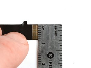

What is the ribbon cable pin count?
I want to hack this controller for a 8 inch wide tablet, but the existing ribbon cable assures I cannot do it stock. The rubber flex back strap and spring combo (versus telescoping hard plastic) gives me hope that if I get a longer ribbon cable, I could also fashion a longer strap. I can't tell from the photos of it's a 14 or 15 pin. Also, what is the current length of the ribbon cable so I can figure out the size I will need for my tablet? Please inform. Thanks!
Hi Jacob, I disassembled the Kishi again and counted. There are 14 pins and the pitch is 0.5 mm. Here is closeup for you.
Based on this close-up, it looks like 14 pins: https://d3nevzfk7ii3be.cloudfront.net/ig...
Unsure what the pitch is, though. I’m considering attempting the same mod myself.
