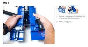

is there a way to detach the hose from the vacuum itself to get a clog out from the bend
Hi @cefranzel ,
Here’s the ifixit Eureka EasyClean 71C Casing Replacement guide. This will help to open the casing so that the hose can be removed and cleaned.
At Step.6 in the guide the hose can be seen being held in position by being slotted into the case. You should just have to lift it out.
(click on image to enlarge for better viewing)
