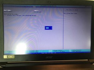

I forgot my Window 10 log in password and bought a program to recover it. This requires me to boot from usb in order to run the program.
However I am facing an issue that there is no option to choose to boot from usb.
I am using Acer Aspire3 A315-41G-R8QG with an InsydeH20 Rev5.0 system

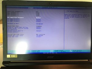

I disabled the secure boot.

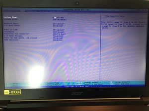

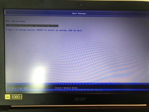

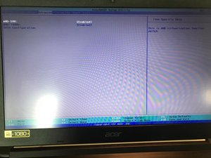

I also attached the screen cap for everyone to understand my situation. Thank you

Look at your second to last photo. Do you see Boot Mode? Change it from UEFI to Legacy.
Power on and then press F12 key for boot menu and select your USB drive and it will boot.

Thanks Mike. But there is no Legacy to pick. UEFI is the only option there . That's why I am stuck here.
