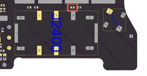

  • Did you check for any pry damage around the battery connector? Accidentally prying FL2400 (see image below) can cause the symptoms you are seeing .

Thanks for the detailed response. My friend got this phone from his service provider brand new and has never had it repaired previously. It seems unlikely they would supply him with a phone, as if it was brand new, if it was in fact previously repaired by somebody, or even refurbished by Apple. I can check for any pry damage around the battery connector, as it's always possible that I did that when I removed it, though I did use a plastic spudger from the ifixit kit and was pretty careful. I have tried connecting to a computer after putting it all back together again and it was not recognised. I could try without the screen on, though I don't like reopening it over and over, as that risks further damage.
